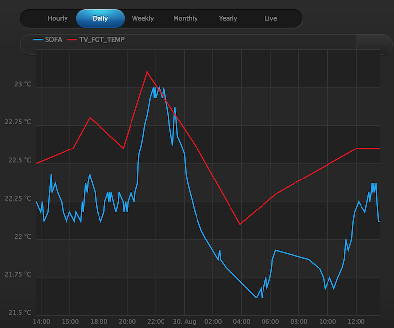

Click on the spoiler to see tracking of the FGT with a DS18B20 sensor in my room:
If that kind of tracking does not meet your expectations than I have really bad news for you: although the BLE probe reports every 10 minutes, the FGT doesn't do that, and there are no configuration options! Don't shoot the messenger, please.
I'm not sure if the "Eurotronic Spirit" with external probe would make you happier. That's the only TRV with an external probe that I know of... It uses another Z-Wave sensor as a probe, but there are some specific requirements. I've read the manual, but I do not own such a device, I cannot tell you much more.
I think, what you want is a "mains powered actuator" for your valves - they exist, but not in Z-Wave. I'm certain some users have them or planned to use them. But then you need a bunch of relays + your own code... If I wanted the ultimate control, that is what I would try...
I cannot tell you much more. I do not sell these FGTs, I am an end-user. But I hate to see other people struggle with this device. We have had a long PM about these valves and I think the FGT cannot do what you want and you will not be a happy customer. It does not matter how hard I try.
The only thing I can do, is post a picture of how well my FGT sensor tracks my "SOFA" sensor...
