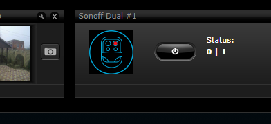

UPD:
can't reproduce!
/monthly_2019_11/image.png.e82a4ea8e917974deff8d31db3e377e3.png" />
Edited by 10der

example
/monthly_2019_12/image.png.d799055375fe2804fa009d3fce2cc72f.png" />
the debug result shows the correct state when pressed, but how to apply it to the previous loop so that the icons and status also change?
aha got.
all was easy
return original loop
goto end of code
REMOVE line
[ SAVE]
PS: for preventing high CPU usage VD update own status every minute (sic!)
