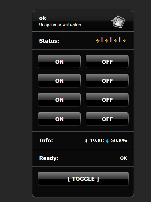

Universal Sonoff device
for example 2x relays
/monthly_2019_12/image.png.fdc2d893f8e8c6a7793b1f5300b0470a.png" />
for example 4x relays
image.png.8dc666dad45e29de5c329ff2c6b91eec.png\\
configuration
local model = 4 -- how many relays?
local iconON = 5 -- icon status ON if is any relays in ON
local iconOFF = 6 -- icon status OFF if is ALL relays in OFF
local iconERR = 1083 -- just provide error status iccon if VD can't update / rcvd status of Sonoff
NOTICE toggle button switch to ON or OFF = ALL !!! relays regardless of current status.
for example if you have  1 ON 2 OFF 2 OFF 3 ON => CLICK => 1 OFF 2 OFF 2 OFF 3 OFF
1 OFF 2 OFF 2 OFF 3 OFF = > 1 ON 2 ON 2 ON 3 ON

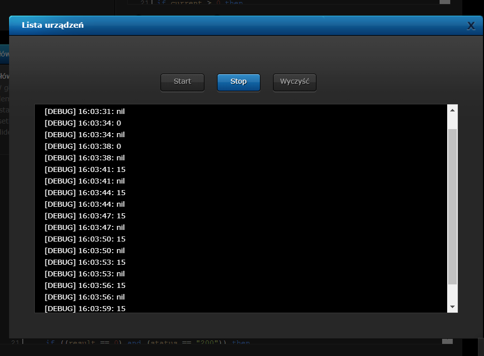

Unfortunately, as I changed the line in the code:
local sensors = json.decode (resp) ["StatusSNS"] ["AM2301"]
this button doesn't work at all and doesn't show the status of the inclusion :-(
/monthly_2019_12/image.png.440b4d63e6881601bef872c7c7c04777.png" />

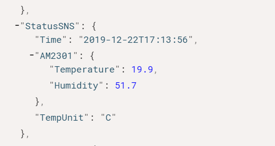

provide me clear json response from SONOFF, cuz according doc JSON should be
How do I enter the command:
http://192.168.1.6/cm?cmnd=status%2010
I receive in response:
{ "StatusSNS": { "Time", "2019-12-22T14: 14: 30", "AM2301": { "Temperature": 19.8, "Humidity": 54.9} "TempUnit", "C"}}
This is the full answer

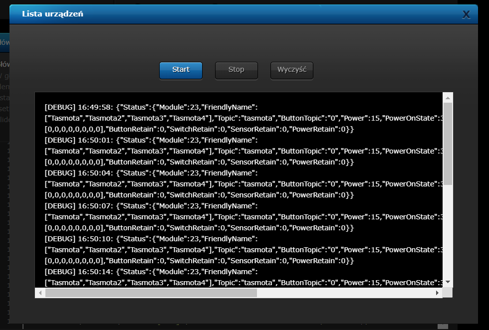

Error: Parse error on line 80: ..., "00000000"], }, "StatusMEM": { -------------------^ Expecting 'STRING'
IMHO forum broke your response
I don't understand what the problem is :-(
after fixing COMMA
/monthly_2019_12/image.png.ed17b91ee9d998f3faa23d3f339a34df.png" />
attach file!!! please attach file.
please attach JSON RESPONSE!
