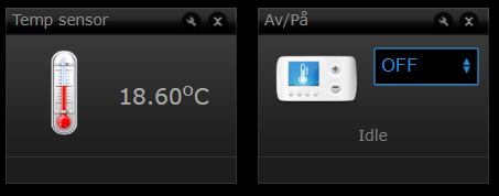

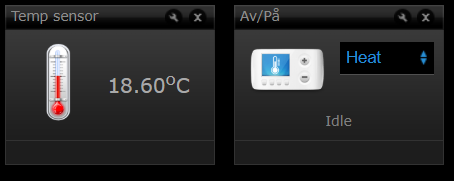

    I'm trying to do the same thing, I have one thermometer and one on/off switch, and would like to control the on/off switch according to the given temperatur.
    Any good ideas how to, easily using blocks ? :-)
