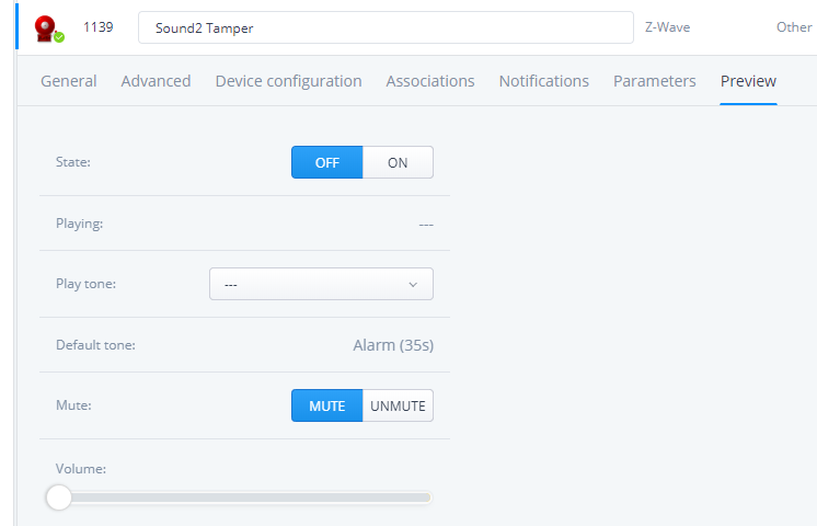

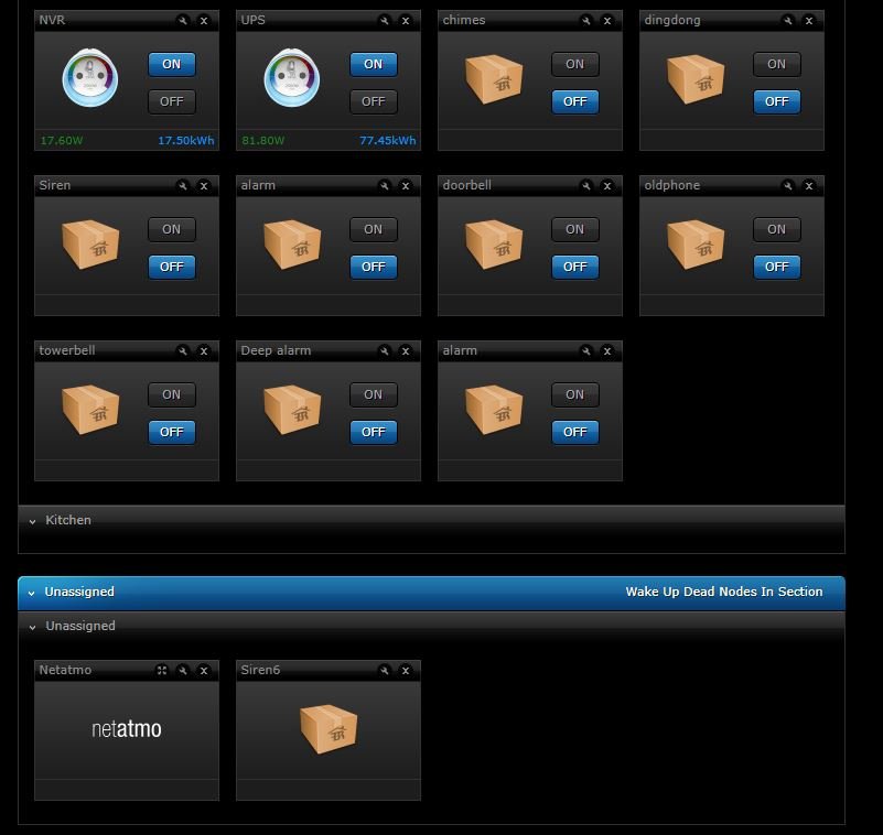

Hi @AndyY, @tinman, I followed the kind suggestion from AEOTED Support: Mr Sebastian Putz (field Application Engineer) Just to confirm you a I purchased a UZB1 from the big sto
