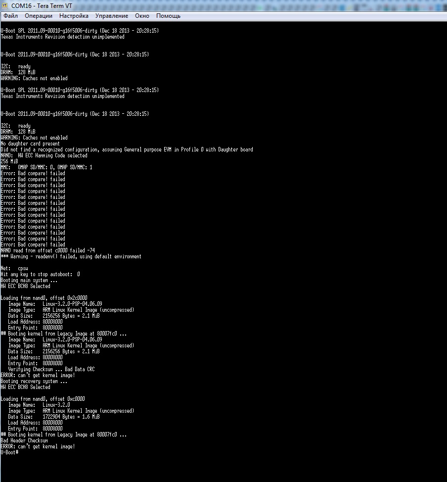

I initiated an update of the HCL via the App a few days ago. After that the contact was lost.
I have tried all recovery options I have found with no luck.
I opened up the HCL and discovered the AM3354 module inside.
I then found the console port (3pins: 0V, Rx and Tx. 3.3V level signals) and see that it is stuck in U-Boot:
U-Boot 2011.09-00010-g16f5006-dirty (Dec 18 2013 - 20:28:15)
I2C: ready
DRAM: 128 MiB
WARNING: Caches not enabled
No daughter card present
Did not find a recognized configuration, assuming General purpose EVM in Profile 0 with Daughter board
NAND: HW ECC Hamming Code selected
256 MiB
MMC: OMAP SD/MMC: 0, OMAP SD/MMC: 1
Error: Bad compare! failed
NAND read from offset c0000 failed -74
*** Warning - readenv() failed, using default environment
Net: cpsw
Hit any key to stop autoboot: 0
U-Boot# help
U-Boot# printenv
U-Boot#
It stops in U-Boot as there are some memory failure, but it does not respond to any known command.
It reboots every 8th minute.
The LEDs are flashing as in recovery mode, but HCL is not visible on the net and and it does do not respond on 192.168.81.1 when PC is connected directly.
I find that a bit strange. Is U-Boot really holding the recovery web server?
If command interface had worked, it could maybe be possible to restore the on board flash using TFTP.

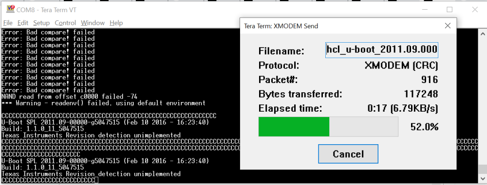

tinman
easier than you might think, this is the SOM used in HCL Please login or register to see this link. (actually this is the v1.1 used on HCL, no idea how many changes are between 1.2 and 1.1 -> afa9
tinman
P2 header, near LAN. If the U12 on the bottom side (near P2 header) is not populated, you will need to solder two bridges (not between middle pins ...) 1 - <----> - 6 2 -
tinman
generally you can boot from lot of source, if you manage to set it: Please login or register to see this link. Please login or register to see this link. Please login or register to see this link.
