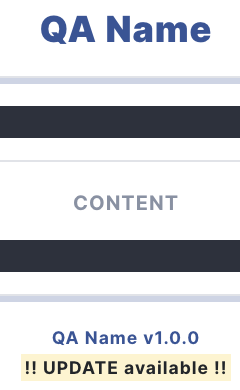

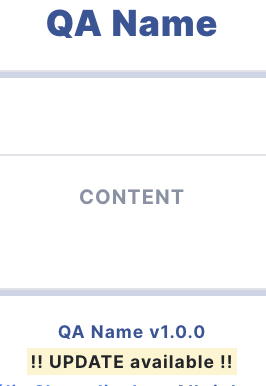

    Here is a way to have better format control over label text.
    We can add to this with a generic table template
    Please login or register to see this code.
    It creates a template with tags that makes it quick and easy to modify text or attributes in the table and update our label....
    Please login or register to see this link.
    Here is a <
    > to HTML4 table and tags.
    I have used your class 'Table' to create a table to describe which buttons was just pressed and all OK.
    Therefor it seems that in "tab2" definition the attribute "bordercolor"=red does not work; I also tried the "bgcolor=red" attribute without success.
    Is there a way to change the color of the borders and the background?
    Edited by Christb
    Link to comment
    Share on other sites
  • Topic Author
    bordercolor does not seem to work. bgcolor do work - at least in the web UI.
    Link to comment
    Yes I have been able to change background color of one cell - I was not using the right position of the "bgcolor=#39f83c" attribute for the cell: now OK for PC and Old application in Old view.😀
