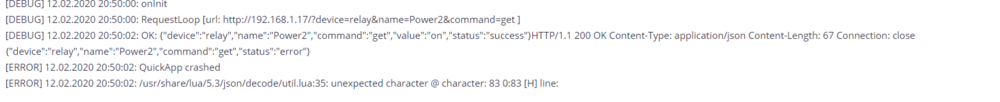

If I want to make a Quick App (VD) with 2 buttons, what is the command to call for a http line?
So when button 1 is pressed I want deviceid XX to turn on ?

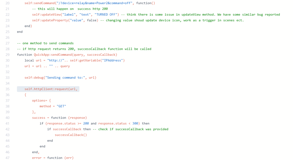

Forgot to attach my example code... Credit wehre credit due, this code is the result of a cooperation of @AutoFrank, @petergebruers and some rework done by Fibaro, which is to say the main issue right
Tony270570
Please login or register to see this code. @ptekienHope it can help

I am not sure if I understand the question, but I can say additional buttons are not working in the app right now, Fibaro is working on new HC firmware and app with bugfixes. But the main function (eg
