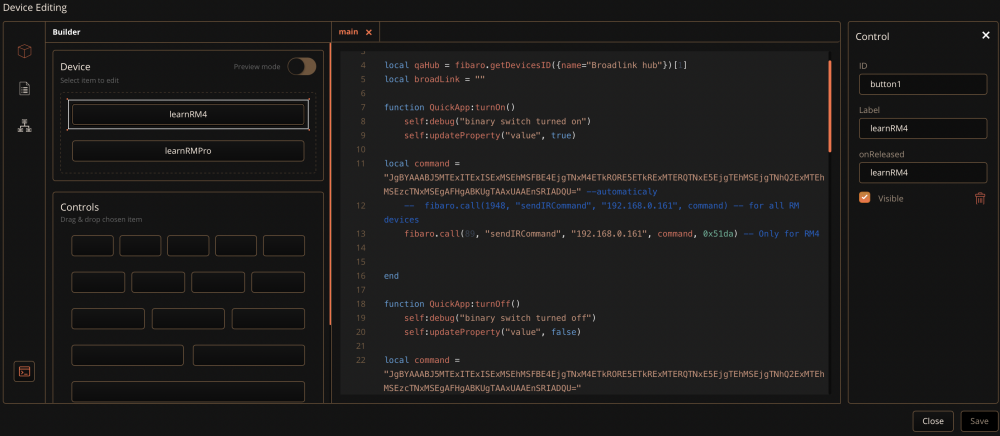

The code copied from you is (and I changed IP and ID numbers to match my setting and I also set both buttons to same ID and IP as I’m not sure which one should work for my RM4 Pro):

And the result I get when pressing either button (learnRMPro or learnRM4) is:
[[09.02.2022] [04:00:21 pm] [DEBUG] [QUICKAPP89]: onAction: {"args":["192.168.0.161"],"actionName":"learn","deviceId":89}
[09.02.2022] [04:00:21 pm] [WARNING] [QUICKAPP89]: Class does not have learn function defined - action ignored
Or
[09.02.2022] [03:52:46 pm] [TRACE] [QUICKAPP90]: UIEvent: {"elementName":"button1","eventType":"onReleased","values":[],"deviceId":90}
[09.02.2022] [03:52:46 pm] [DEBUG] [QUICKAPP90]: button1 turned on
It seems to change message after a 10 minutes - one fills in the IP address then 10 mins later has it left blank!
But no light on the RM4 Pro (so no indication it is ready to learn a IR remote button).
When I press the binary switch on/off button I get:
[09.02.2022] [03:54:44 pm] [DEBUG] [QUICKAPP90]: onAction: {"deviceId":90,"args":[90,"turnOff"],"actionName":"turnOff"}
[09.02.2022] [03:54:44 pm] [DEBUG] [QUICKAPP90]: binary switch turned off
[09.02.2022] [03:54:44 pm] [DEBUG] [QUICKAPP89]: onAction: {"args":["192.168.0.161","JgBYAAABJ5MTExITExISExMSEhMSFBE4EjgTNxM4ETkRORE5ETkRExMTERQTNxE5EjgTEhMSEjgTNhQ2ExMTEhMSEzcTNxMSEgAFHgABKUgTAAxUAAEnSRIADQU="],"actionName":"sendIRCommand","deviceId":89}
[09.02.2022] [03:54:44 pm] [ERROR] [QUICKAPP89]: Can`t send code to device 192.168.0.161
Which would indicate the RM4 Pro is not receiving the signal (In understate the IR code is your specific one for your AC - but I would expect my RM4 Pro to at least be able to receive it and send it out even though I have no IR device that would recognise  that code).
Then:
Pressing the LearnRM4 button again I get a different message:
09.02.2022] [03:58:14 pm] [TRACE] [QUICKAPP90]: UIEvent: {"elementName":"button1","eventType":"onReleased","values":[],"deviceId":90}
[09.02.2022] [03:58:14 pm] [DEBUG] [QUICKAPP90]: button1 turned on
[09.02.2022] [03:58:14 pm] [DEBUG] [QUICKAPP89]: onAction: {"args":["192.168.0.161",20954],"actionName":"learn","deviceId":89}
[09.02.2022] [03:58:14 pm] [WARNING] [QUICKAPP89]: Class does not have learn function defined - action ignored
Really appreciate your help on this. I know enough about technology to be dangerous - but not enough to get it working!

23 hours ago, Phenix said:
Glad we got it sorted
Yes - was user error on my side! I was putting the binary switch ID instead of the Broadlink Hub ID.
Thanks for the great support!
