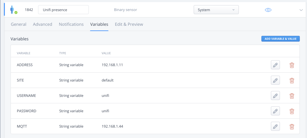

    Does this quickapp work with cloud-key-gen2-plus?
    • 8 months later...

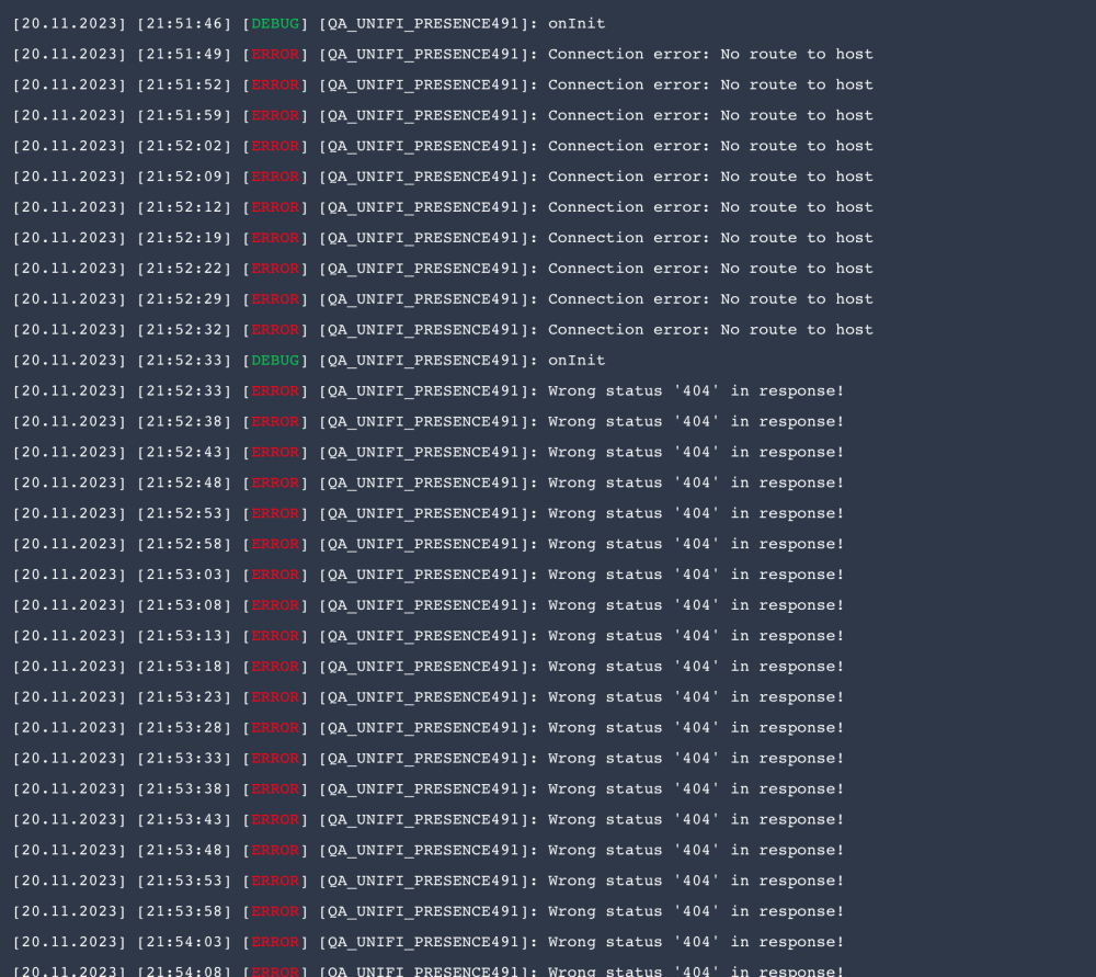

    Hi, yes it does only the API addresses has to be adjusted so I did :D (else it won’t work with Unifi OS/ Cloud key Gen 2) as address only fill out the IP.
    Only the 401 error keep returning, I didn’t bother trying to fixing it

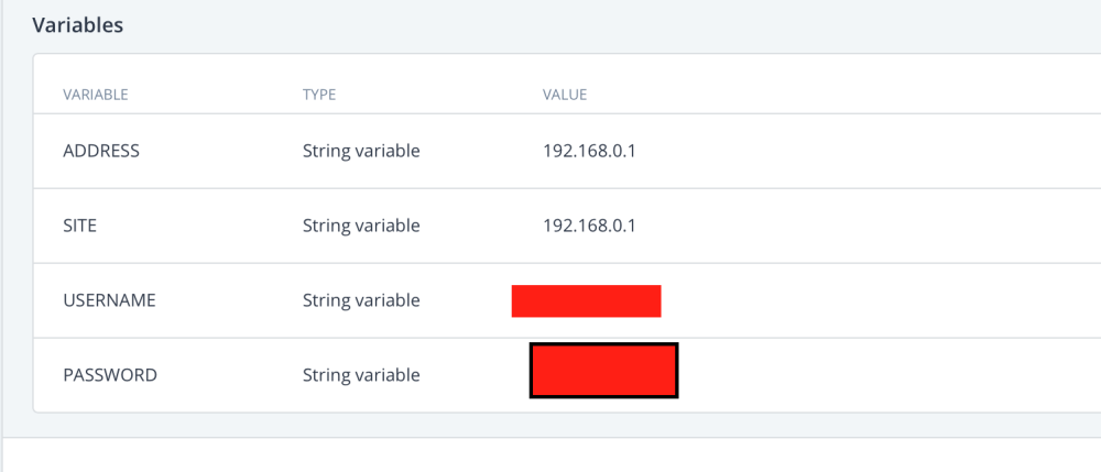

    Hello, totally newby here, I am trying to install this. Does it work with dream router and unifi OS? Do i have to make any changes under LUA code or only set up variables?

    It is ubiquiti equipment only difference is that dream router doesnt need cloud key for remote connection. I have unifi OS, but just not able to set up everything
    A Dream router uses the same OS as a Cloud Key Gen 2 so ... it should work (the API is the same)

    Hey to make it work for UDM I had to change some API points. I'm not a programer, but it works on my UDM-Pro
    SLAVA UKRAINI!
    function QuickApp:getDevices(func)
        self:unifiClient('https://' .. ip_address .. '/proxy/network/api/s/' .. site ..'/stat/sta', nil,
            function (data)
                    if data.meta and data.meta.rc and data.meta.rc == "ok" then
                        func(data)
                    else
                        -- error?
            end,
            function (err)
                if err.status == 401 then
                    -- do auth
                    local login = {username = username, password = password, strict = true}
                    self:unifiClient('https://' .. ip_address.. '/api/auth/login', json.encode(login),
                        function (data)
                                    print("login OK")
                                    self:getDevices(func)
                        end)
    SLAVA UKRAINI!
            function (data)
                        func(data)
                    else
                        -- error?
            end,
            function (err)
                    -- do auth
                        function (data)
                                    print("login OK")
                        end)
    I don't get it, what exactly did you change to what? I am still not able to get it working on my dream machine
