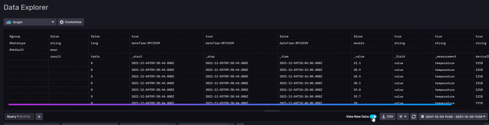

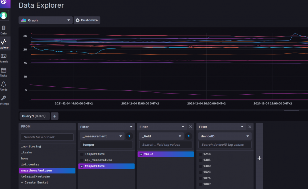

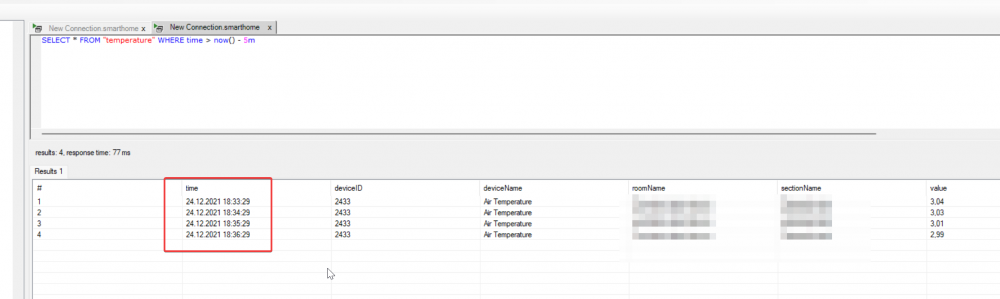

    On 12/23/2021 at 12:17 PM, B_b_B said:
    But the big question is, any idea how to fix my issue ;)
    Or maybe change the question, does your script run on HC3 with the multiplier?
    what issue we are talk about?
    this script working about 2y since my HC3 start working.
    this code works like a charm
    here is proofs
    @B_b_B it's good to have your HC model in the signature. It seems like you have an HCL?
    In that case they have compiled the Lua engine with only 32bits integers so you get an overflow when multiplying the epoch with 1000000000.... @10der don't have that problem as he runs on a HC3 (event though it tturns into a funky scientific representation (float + exp) that influx seems to be able to handle...)
