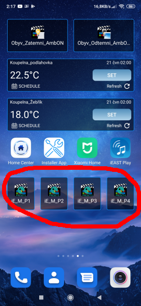

Yes, Fibaro does not yet support QuickApp display in the current version 1.7.0 for Android.
I work around it by having scenes created by which I call QA (button) functions. I made my own icon for each function.
These icons then appear on the phone as widgets for scenes :)

    I now need to do a plug-in (QA) for iEast. But I have an opinion that we do not need to have another application identical to the factory on smart devices. I take it that I use only basic functions. It is important that there are all the functions in QA that you can call in scenes and thus integrate with home automation. Therefore, I think that in some cases a graphical QA interface is not required for smart devices.

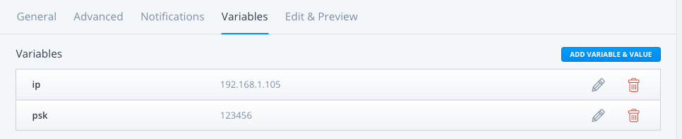

    I can´t import the VD in my HC3 and if I open the VD in a text-editor it is really messy :) but I searched for the IRCC code for "Power" and it is the same as in my QA so at least that should work.
    My TV is Android TV v7.0
    Follow the instructions on
    The only thing you should need to edit in the QA is the IP and the PSK
    Ip is your TV´s IP-address and psk is the key you have set in the TV configuration, it looks like your key is set to 0000 if I look in your VD.
    If it still isn´t working double check the instructions on
    OK, work fine now. Thank you! :)
