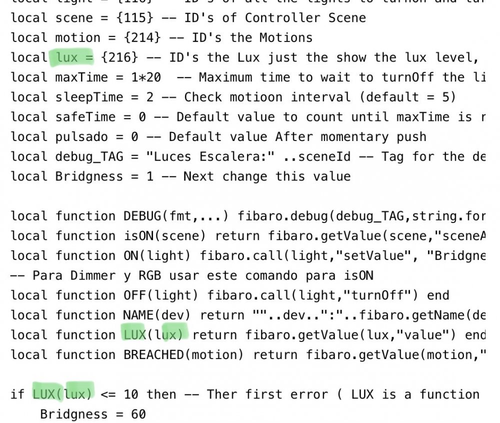

    Guest Benrive
    Hi, U used the first LUA for @chiel-s.
    I only one sensor lux , i think this error it's for de same.
    In second script i hace the following error but ,I can't find how to solve it.
    In the first scene to the averageLux , debuf tag for media lux it's 211.0
    [SCENE15]: (load):24: attempt to concatenate a nil value (local 'localLuxAverageRoom')
    Edited by Benrive
    Looks like an average is not calculated, because you have only one Lux sensor.
