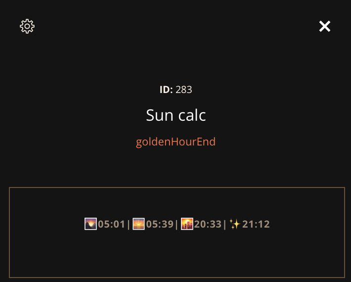

    Does it work on HC3, is this a QuickApp?
    I tried adding the file but it just adds as a generic device with no code by the looks of it (com.fibaro.genericDevice)
    4 minutes ago, theuksbest said:
    @10der - that looks good, i could benefit from something like that
    maybe cuz you have old HC3 fw?

    Looks like it's working now, but..
    it doesn't seem to load an icon. Did i do something wrong?
    @theuksbest sorry. you can't.
    setting icons for generoic deivce is tricky.
    btw, check global params for a new global param value.

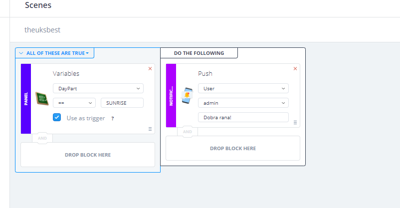

    @theuksbest hust create
    DayPart
    like
    /monthly_2020_08/image.png.e85c035e0973782cac53c786b4b87091.png" />
    after 1 min variable should re-filled
    than you can use this var with more details sun events

    /monthly_2020_08/image.png.5b628d0fb9fbb7e8831e937a243b13f9.png" />
    is the what you asking?
