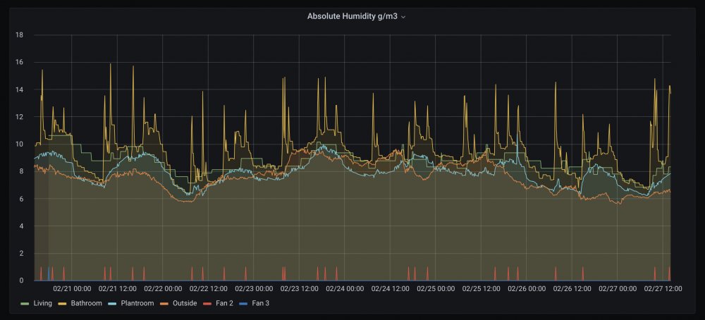

SmartHomeEddy
With the help of InfluxDB and Grafana I got a great insight of a comparison of the humidity. Because I now can compare Absolute Humidity, it is more easy to get a better setpoints for my Fan

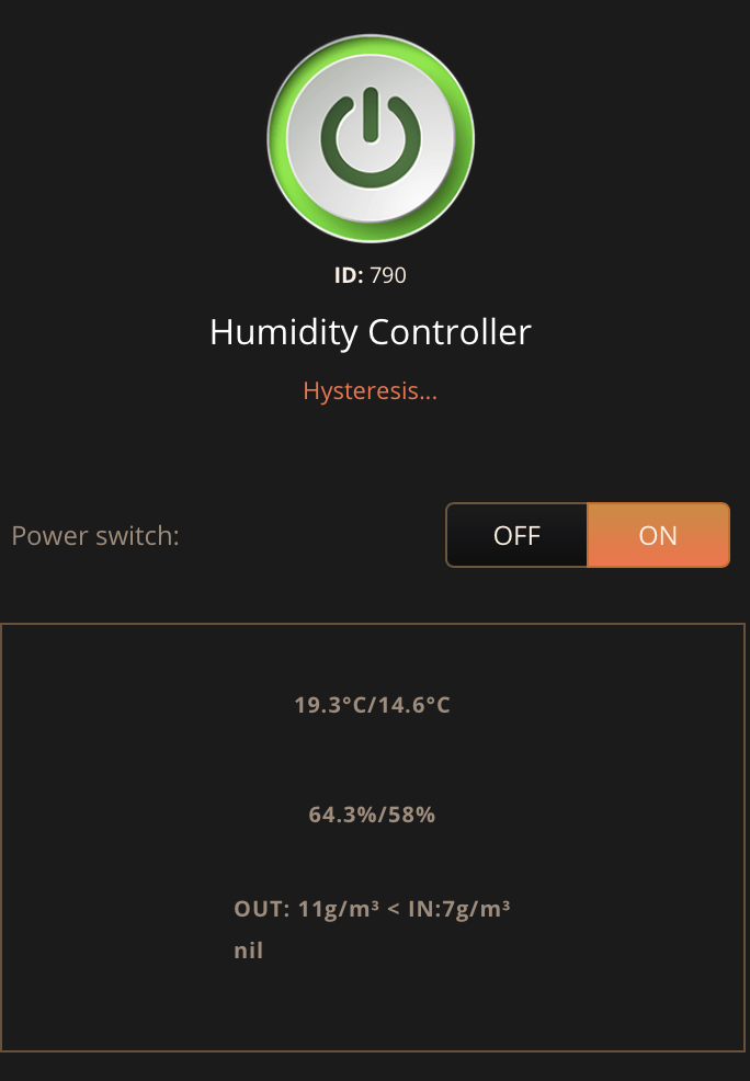

10der
@muhmuh do not forget setup Id's via variables pressure device - optional. default is Standard sea level pressure is 1013 hPa switch - also optional.. default only
