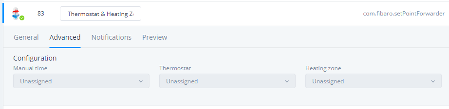

Could anyone make the Thermostat & Heating Zone plugin work in HC3? This one:
/monthly_2020_10/image.png.9a3cd345b045edd9e6096f952f8a7648.png" />
I can install it, but cannot set it up under the Advanced tab:
This plugin works correctly under HC2, and allows to override the climate schedule to manual mode with a wall thermostat. I have a Heatit Z-Temp2.

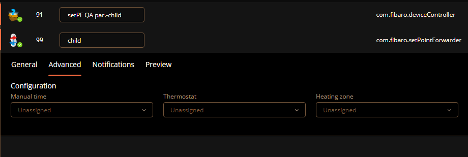

    working on replacement for that, so far the functionality is working for heating and cooling thermostates (not sure if i manage to add support for auto mode).
    /monthly_2020_10/image.png.59f28e7864ba32da4dc23fcf069903e8.png" />
    Currently fighting with (normally not supported by QA) listboxes in BUI, to make the user experience same as with original plugin
    Spend hours on that already, if i didn't manage that, i will post the QA without, so you will have to enter manually heating zone number and thermostate id.
