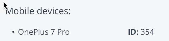

do you have a way like this, to get GEO Position from Android devices? - my son is not an AppleFanboy ;-)
    No, and mainly because I don't have any Android devices.
    But as I understand it, it should be possible. Maybe someone with Android devices can develop it?
