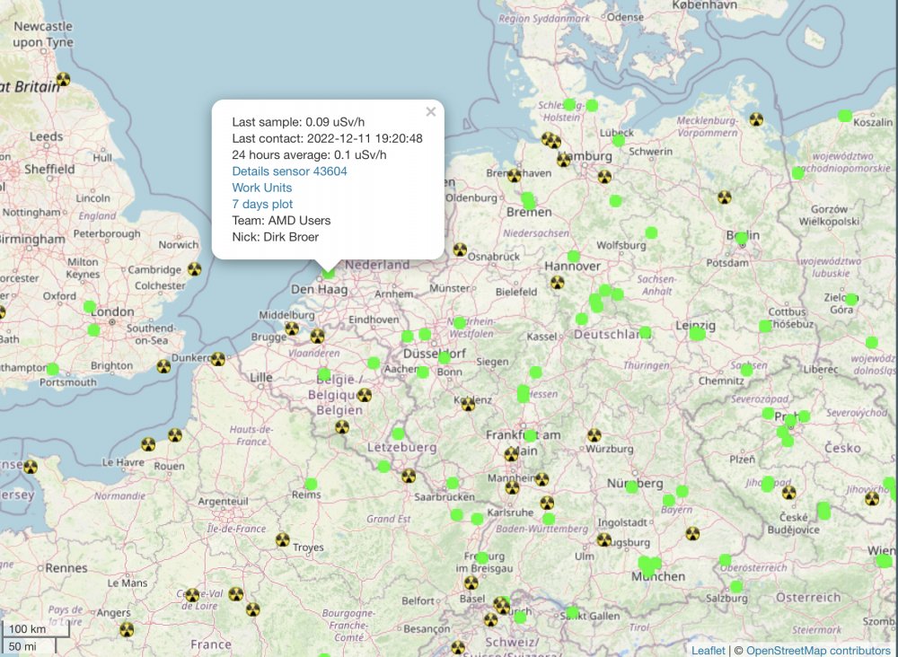

    What I do wonder, and that has nothing to do with your quickapp. When I look at the positions of the sensors, they are all quite far away from the reactors. The Netherlands does not even have its own sensor. I would have placed one near Borsele :)
    • 0
  • Inquirer
  • Posted
    There is a sensor near Utrecht, but it is offline for two weeks now. I also looked what is needed to build a sensor setup, but haven’t figured that one out.
