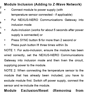

Hi all, I’m new to the FIBARO ecosystem and need some help connecting some existing third party modules.  The house I recently moved into has a number of Environexus Nero-Relay and Nero-Dim modules wired in the wall behind the switch plates.  Problem is that the previous owner took the gateway with them.  I have opted to use the HC3 Lite which I was led to believe should connect to the existing relay and dimmer modules (all z-wave based).  From what I have been able to find on the internet, I should just be able to press the sync button on the relay for >3sec (or toggle the connected switch 3 times) after putting the HC3 in inclusion mode and the controller should connect to the module.  It never does, the inclusion mode timer just times out and prompts to retry.

    You have to set the hc3l in exclusuion and then on the nero relay hit the button 5 times or 6 sec. And the hc3l controller shuld say exluscion complete or somthing.
    Then wait a minute or 2 and start the inclusion on the gateway and hit the button 3 times or 2sec and you should see the device getting added 🤔
    This have to be done on all devices you want to add to a new gateway.

    Yeah that’s what I have been trying but I don’t see any messages on the console apart from entering exclusion/inclusion mode.  I wonder could it be that other devices on the old network are preventing the exclusion process?
