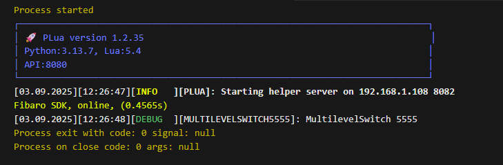

    Hi Jan,
    I'm very interested in the PLUA development environment and trying to set it up.
    Everything is set-up correctly, but when executing some test, the PLUA process stops immediately after having initalised.
    e.g.
    • I launch a Simple multilevel test QA using 'plua --fibaro main.lua'
      The Quickapp UI starts, but looses immediately the connection because the process has stopped.
      /monthly_2025_09/image.png.434aa1c66d445d4ac2982b1e23404a80.png" />
    • The same with VSCODE debug mode, even not passing in the QuickApp:onInit() function
    The only way I'm able to make it works is with the '--interactive' mode. It keeps the process running and it is all ok.
    But the interactive mode doesn't seem to work if I add the parameter in the launch.json.
    in vscode
    If I activate the debug logs, the logs end with :
    Something might be wrong in my configuration, but I do not see anything else I can do.
    Thanks.
    Hi, I'm happy you want to test Plua....
    1. Per default, Plua terminates if there are no timers running. It is controllable with the --run-for flag,
    In .vscode/launch.json I recommend to add
    A positive time terminates plua if there are no timers after that time (60s in the example)
    A negative value makes a hard kill of Plua after the time.
    A value of zero runs forever - or until ctrl-C (or stop/restart in VSCode)
    Interactive mode sets the flag to 0. Interactive mode can't be run from VSCode as there is no stdin to read commands from...
