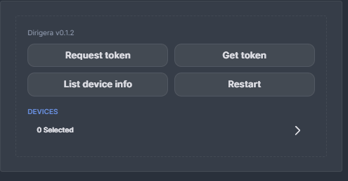

    Seems to be somthing strange with the uploaded file:
    /monthly_2026_04/image.png.c8e4afae1381ff8e7c2aec13d0783a75.png" />

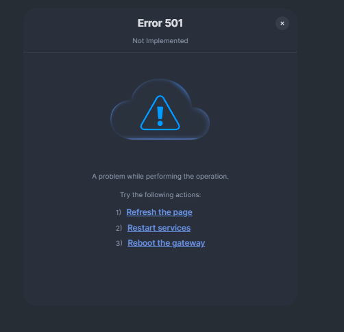

    When trying to open the files with the ; ending
    Also crashed on Request token:
    And only version available is 0.1.2:
    In the forume for Ikea Dirigera QA it is v1.0.0
    Edited by Brors94
    Now dirigera should work. My development version had named the QA files with a ';' at the end, which the HC3 didn't like.
    0.1.4 latest.

    I have an instance on one of my hc3s with the verion v1.0.0 from the forum.
    Does the Dirigera support 2 at the same time?
    The dist QA and the new dirigera instance is on another hc3.
    I have also changed the ip on the new uploaded fqa*
    Well, it should cope with 2 instances - it may reject a get token requests if there are a lot of requests...
    I uploaded 0.1.5 that should give a better error message for failed get token and hopefully not crash.
