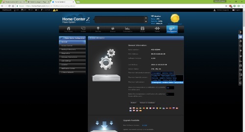

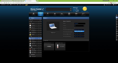

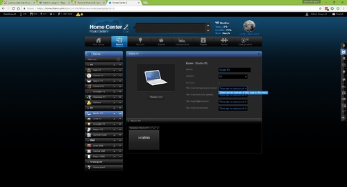

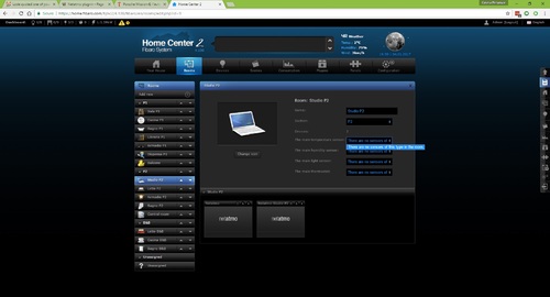

    This is a room with a Netatmo thermostat, I can expand the device and change its parameters, but the panel tells me there are no temperature sensors nor thermostats
    Guest Lode
    16 minutes ago, kdikomunismo said:
    Yes, sure.
    Can you change the value of "Main temperature sensor" in the second screenshot ?
    Nope (see screenshot).
    Same thing with "The main thermostat:" menu
    Guest Lode
    And in "Devices" they are all set to the exact room ?
    Yes, the only "unassigned" is the general Netatmo plugin, wich is the one I use to set the connection parameters and give the "get devices" command
