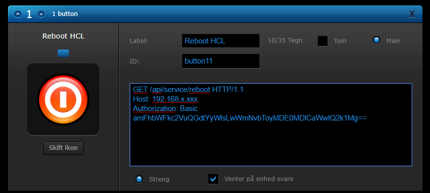

This works for me and i even tested it with HC2 (v.4.134 beta)
GET /api/service/reboot HTTP/1.1
Host: 192.168.1.9
Authorization: Basic
bmV3YWdlc3lzdGVtc2x0ZEBnbWFpbC5jb206TW9ycGhhZHJvbjE5
Port 80 for the virtual device.
And yes, there are 2 lines below the code. When i change the view to LUA the code for username:password appears on the same line with the Authorization: Basic and it is easier to add two more empy lines below the code.

You can test this, (for version 4.130 or more) :
Change your VD ip:127.0.0.1 and port:80
And you MUST enter two empty line at the end of the above string!

Worked! The issue was to change:
POST -> GET
Settings -> Service
11111 -> 80
0x0D0x0A0x0D0x0A at the end
The rest is still the same.
Host: 192.168.5.7
Authorization: Basic c3XXa25vXXXXXXXXXXOlNhbXXXY2Nw==
0x0D0x0A0x0D0x0A
ok, can you post a screenshot your VD code?
In the General tab, you need the actual IP adress with port 80.

Mine is below. IP and port 80 on the main page correct as well.
Host: 192.168.1.16
blablabla==
0x0D0x0A0x0D0x0A
