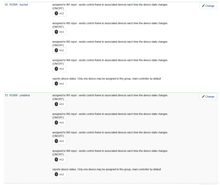

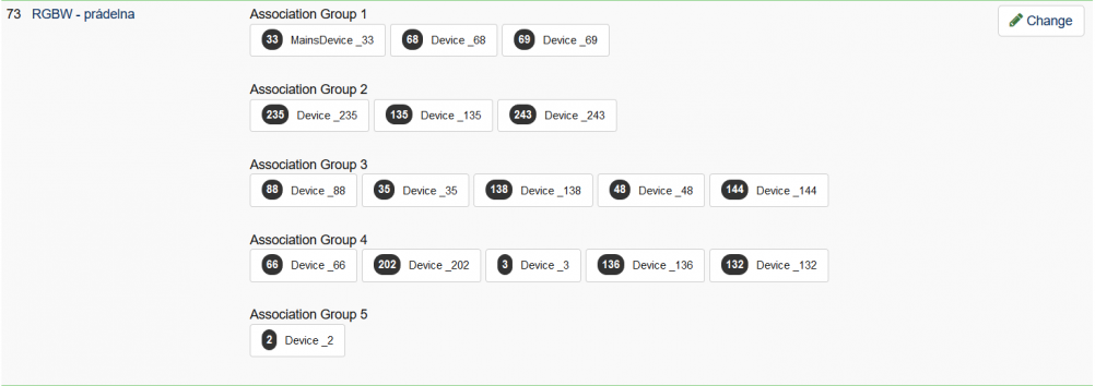

Right so here is a problem:
SOMETIMES (rather sparsly but still enough to warrant me bugging Fibaro about it) RGBW makes phanthom associations for no bloody reasson.
It happened a while back and only replacement of specific RGBW module seemed to help that was in pre "100" era tho.
Most recent case i have are 2 RGBW modules (v 2.5) running on same HC2 4.100, reading tempriture and humidity via IN1 and IN2.
Confirmed at least one of them caused it (once disconnected from power the random behaviour stoped), second of those RGBW is very strong suspect. Sad thing is that the second RGBW seems to have worked fine untill the first one was disconnected.
Now i seek aid, advice and wisdom. if annyone had this happen to them please add your controller, its FW and mofule's FW aswell - lets see if we can help fibaro figure this one out!

@AutoFrank, unwanted associations were fixed with the last firmware version (26.25). We do have some information, that even after update, some devices are being turned on and off by themselves. Z-Wave team is looking at it.
We need to be sure, that every RGBW controller has been updated do 26.25 version and if you don't have any other RGBW, which is working, but is not connected to Home Center (therefore weren't updated).
We have a workaround - a LUA scene, which clears all the associations once a day, I will send it to you.
