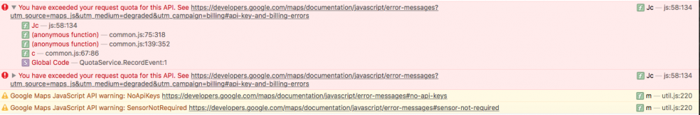

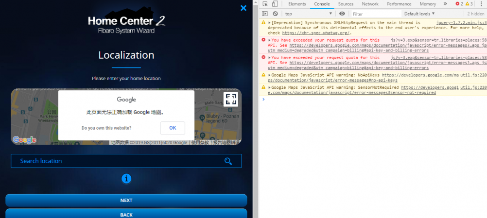

At first, I couldn't find the possibility to change the location at all, as the Longitude and Latitude information appear like static labels on the Configuration->Location page. Then, after using Safari browser, I found a hidden button (please see screenshot #1). But, after clicking this button, I was redirected to the page with the broken map (please see screenshot #2). I stuck on this page as no matter what I do, the location doesn't change.

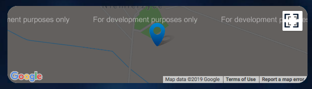

it should be a warning not error! Please login or register to see this image. Please login or register to see this spoiler. ha - ha! it's easy! just login to Google All requests
10der
also, you can try Opera browser. it can pass all http requests via random VPN proxies. maybe it helps you. Please login or register to see this link.
Dmitry M.
Thanks for this workaround. Surprisingly, but it still doesn't change. Here is a screenshot of what I'm doing (attached). I noticed that, with this approach, I can change any other information. For ex
