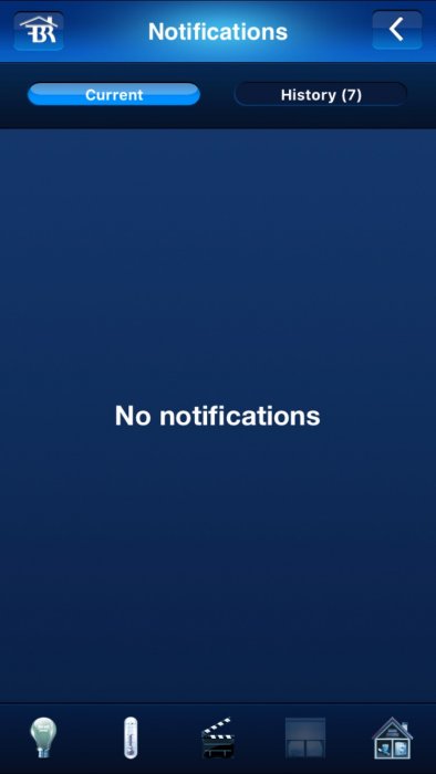

To explain my last post a little further .. 10 notifications showing in the app bubble at the bottom ..
Zero notifications showing within the app ..
and no notifications in the notification centre ..
Can you record the push notifications it sends ? or if not, then it shouldn't show the bubble :)

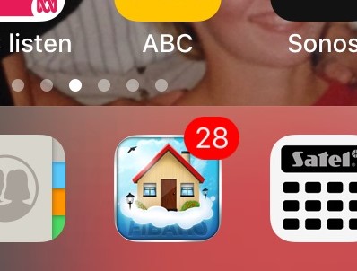

Hi @I.Srodka, yes, as per @KristianO ..
Indeed, now I am using push for a particular scenario, ( I usually use telegram ) it increases ..
/monthly_2018_03/Image-1.jpg.fdb9197b61f9784ef2f42aa06c841c2f.jpg" alt="Image-1.jpg.fdb9197b61f9784ef2f42aa06c841c2f.jpg" />
doh !

Not a bug? I see by the icon I got 12 push notifications reported on the app. Where are they? In history I got only 1.
I set the settings to keep the history, but it’s still not.
