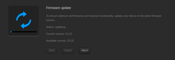

    In my case my Wall Plug devices had old firmware. My algorithm was:
    0. Make backup for controller.
    1. Add (include) the Wall Plug. It has status: Not configured. Not a problem right now...
    2. Go to device settings -> Advanced tab
    /monthly_2018_11/1296604883_notconfigured3.png.2f34730a7064e667238f014753903e4c.png" />
    3. Find "Firmware update" section. Press "Check" button. My device had 22.22 version. Latest version was 25.25. Press "Start" button for update firmware on the device.
    4. After device update restore controller from backup.
    5. Reset the Wall Plug as described here
    • Insert the device into a socket
    • Press and hold the B-button
    • Wait for the visual indicator to glow yellow
    • Release the B-button
    • Press the B-button again, briefly
    • Successful reset will be confirmed with the visual indicator changing colour to red
    • Visual indicator and Wall Plug’s relay will turn off
    6. Add (include) device again and now it has correct state.
    I think Fibaro engineers should create notification something like "Please, check for firmware updates for device" if after inclusion process device has "Not configured" status or automatically check for updates after include and show notification if updates are available.
