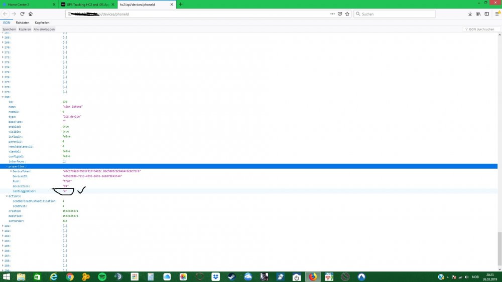

    As I understand you've set your users to send GPS location every few minutes, right?
    Now, where you're trying to see in HC2 the GPS data?
