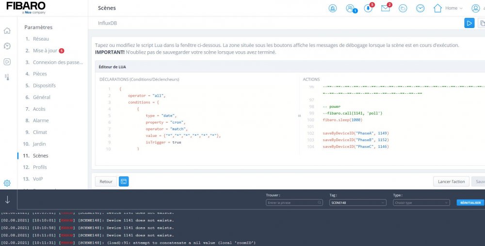

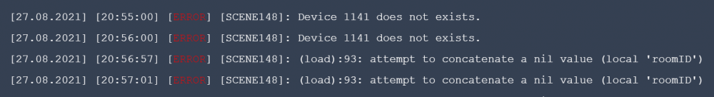

    Thanks. Just tried to create the scene, changed the IP address and the database to match my environment but I have the following error :
    /opt/fibaro/lua_engine/lua/lib/json.lua:185: unexpected character '' at line 1 col 1
    Link to comment

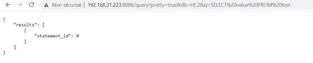

    just test open url in browser
    http://192.168.1.10:8086/query?pretty=true&db=smarthome&q=SELECT value FROM test
    Link to comment
  • thats Ok!
    so you wrong configured scene.
    let go to line
    -- print(url)
    and uncomment
     print(url)
    Link to comment
    Mmmm.. Still the same error after uncomment :
    I should use a scene, correct ? Not a Quick App ?
    Link to comment
    yes! still!
    just see to LOG!
    Link to comment
  • my face palm.
    remove line
    local jT = json.decode((fibaro.getGlobalVariable("HomeTable")) or "{}")
    at all
    Link to comment
    Oh, wait : what is this variable here ? I don’t have the HomeTable global variable :
    Ahah, you’re quicker than me. I’m trying
    WORKING !
    You’re a boss ✌️
