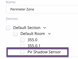

    This is really Great.?
    A small comment
    The Binary Sensor dont work with the alarm, but you can change the QA to a door/windows sensor instead, and its gets recognized by the native HC3 alarm.
    Amazing work @jgab?
    /monthly_2021_01/image.png.c8d84c20d2fc3bf8cc9ba022ec443353.png" />
    Edited by ChristianSogaard
