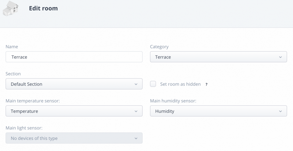

In editing your room “Tuin”, you can assign a temperature (and humidity) sensor to your room.
Select menu item 4
Tap the room once
Tap on  . . .
Select edit

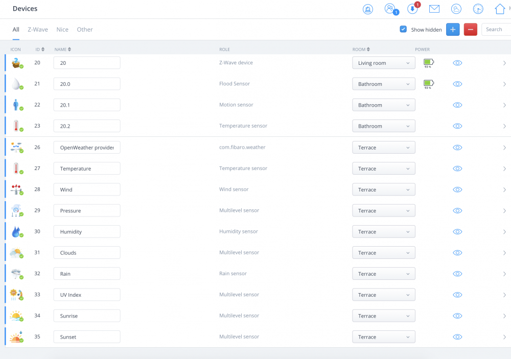

@Fireman You could edit the code in OpenWeather widget
Change multilevel to temperature, delete the wrong temperature quickapp and a new one is created and will be ok

You could ask the author of the QuickApp to change the type of the Temperature Child device.
I left a issue on GitHub, but no reactie up til now. I don't know if the author is on this forum. You could react on the Marketplace.

He wants to select the device in a room, as main temperature sensor of that room.
On 9/25/2020 at 7:44 PM, Fireman said:
And i can't select temp ID440. Perhaps it is a multilevel sensor?
