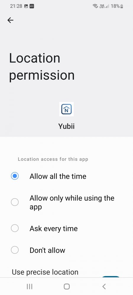

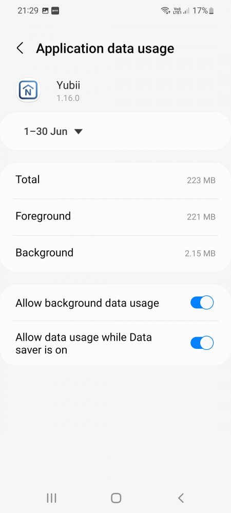

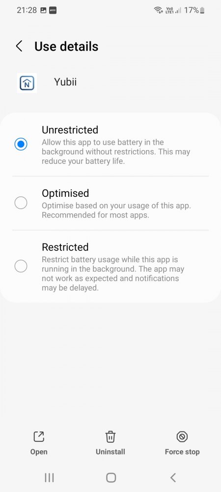

Hello guys
I have tried to contact fibaro support regarding my geofencing issues, but appart of thedefault questions and answers unfortunatelly noone could help me.
Maybe here I can find some answers.
My geofencing doesn't work at all. Never triggers.
All the usual, and necessary settings are correctly set up.
Location allowed for always
No restriction to run in backround
No battery saving restriction
I enabled for Yubii everything.
I have tried with several different accounts, not only with admin.
Double checked gps coordinates.
I YUBII setting, geofencing is ON, so as I say, everything is set as it should be. Still nothing triggers.

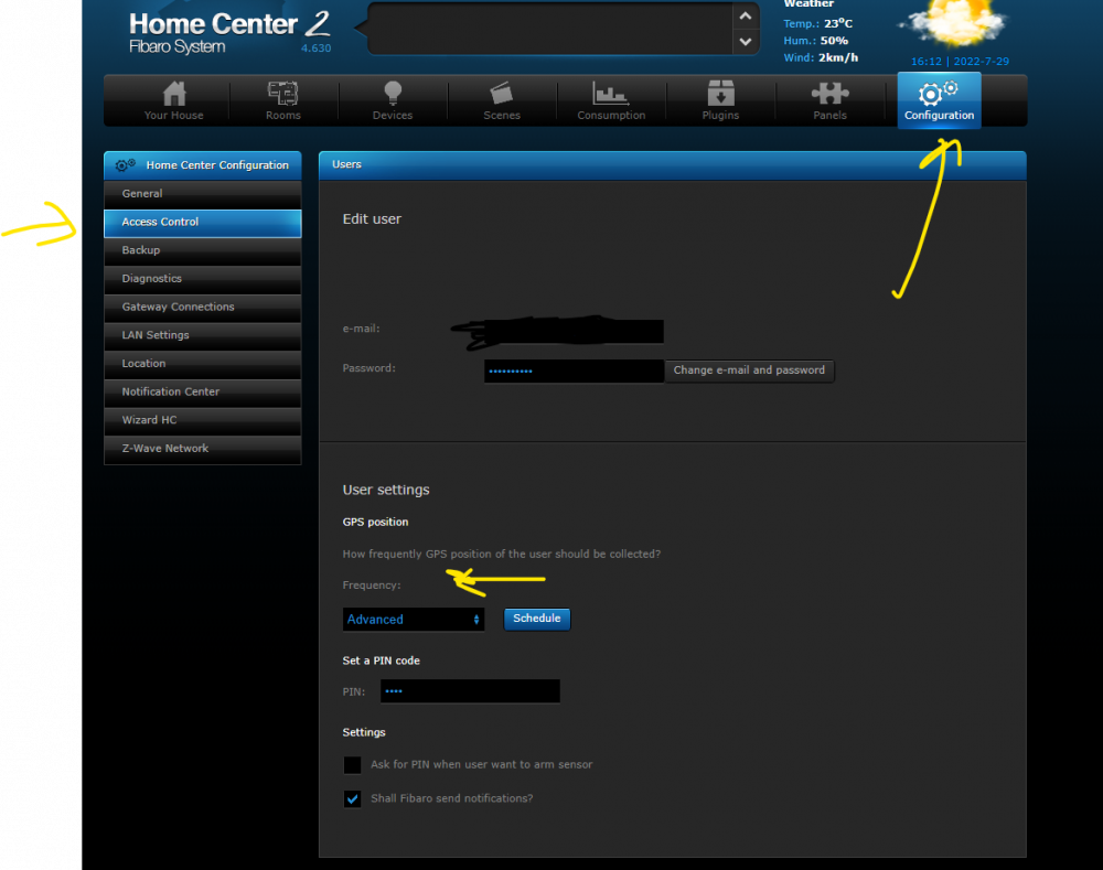

Please login or register to see this attachment. Please login or register to see this attachment. Please login or register to see this attachment. Please login or register to see this attachment. Please login or register to see this attachment. If anyone solve this for m

That's very strange , I am using Geofencing for years (HC2, HC3 and Yubii ) and it works just fine (except some delays on location reports). I have 2 android (Samsung) and 4 iPhones.... no probl
