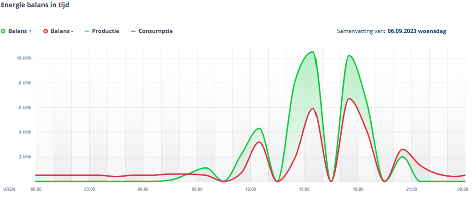

    I too have had unexpected reboots and freezing of z-wave devices. In addition, I have had dips in my energy panel and reports of 'possible performance decrease due to overheating'.
    /monthly_2023_09/image.png.0acb6c7a6384744907bcb19b5b2bce6f.png" />
    I have 71 devices and am advised to change my time interval polling from 120 s to 440 s via the Z-Wave menu.However, this does not work, because the value keeps returning to the original value. Maybe this is a bug in the firmware. Currently I am using version 5.140.17. I hope Fibaro support picks this up. My solution has been to disable polling for devices, as cag104 indicated.My hc3 has been running with this setting for a few days now and have not experienced any problems yet. In fact, I no longer have dips in my energy panel and no more messages of overheating. Hopefully Fibaro Support will solve this in the next firmware update.
    /monthly_2023_09/image.png.ce36d8bf2b2c7c874c97f19c196185bb.png" />
