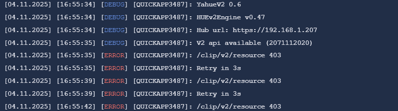

    Just bought a Philips Hue bridge Pro and some ledstrips :D
    Testing this QA and filled the IP and ID of the hub (on the hub page ID , 2 lines above the IP in the app)
    only got 1 light, but it is in a Room and a zone 🤔
    and gets this:
    15 hours ago, Brors94 said:
    and gets this:
    Looks like the Hue_User key is wrong?
