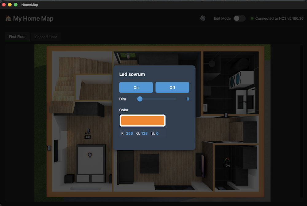

    But I also have some questions :D is it possible to control the lights from the Homemap? :D

    Yes, the light and lightdim widgets have actions defined.
    Would need an action for color lights too...

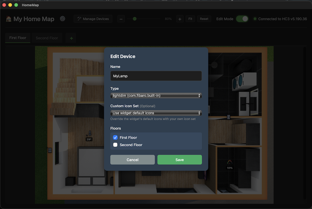

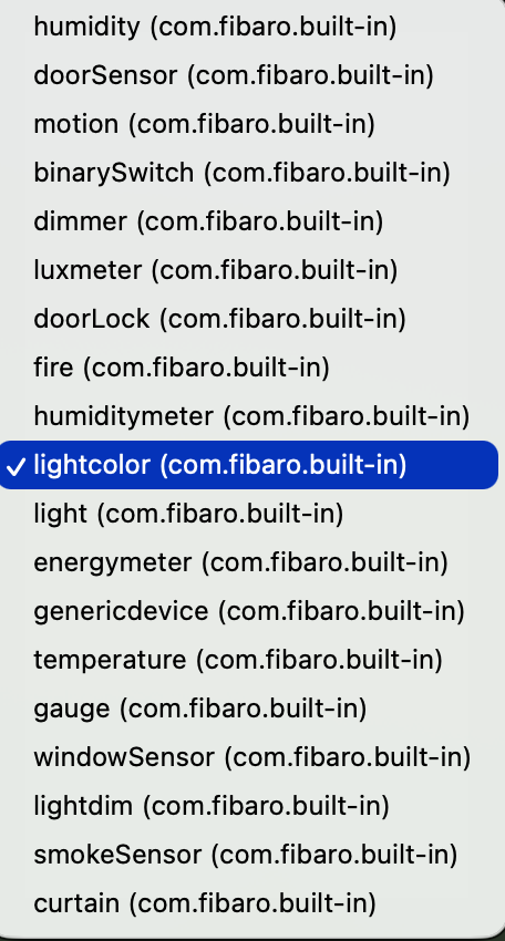

    Found out why I couldnt control the lights :D had to change to type: lightdim instead of just light :D

    Now the actions are not so complete, the dim misses on/off etc.
    - we should be able to control colors and sizes/scale of widgets too...
    Yea, I was actually thinking of scale on the Icons/widgets right now xD  :D
    and maybe a Dual temperature sensor?
    As you see I got 2 Temperatures on the room (floor and Rom temp)
    Just to give you an Idea :D

    @jgab I am just wondering if I want the same device to apper on 2 "floors"/maps?
    Now I have to add the device twice right?
    Example want an own room view and and whole floor view :D

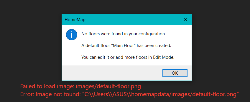

    Jan I seem to have some difficulties.
    If installed the app, privacy en security, gave permission to install.
    The app opens, with error no homedata, I check updates>> have the latest version.
    Create configuration >> pointed to desktop>> open >> enter >> error
    Create configuration >> pointed to desktop>> enter >> error
    HomeMap_0.1.3_x64_darwin.dmg Macbook with Intel processor
    What is going wrong?
    That's a good idea. Planning that edit mode will have a popup to move a widget between floors, but it could be a multiselect.

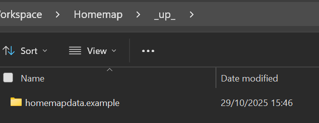

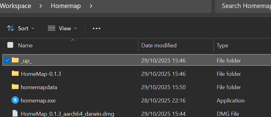

    Just trying to help by telling how I did it :D
    Downloaded all the files from jgabs repo and stored it in a folder
    then run the .exe file and select the same folder
    go into the "_up_" and copy the "homemapdata.example" file and paste it in the main folder
    then go into the "homemapdata" folder and add images and adjust config.json
    and the .env file with the creds, but it seems like you have that okey.
    • A homemapdata folder will be created with templates >> is not created
    2 hours ago, Brors94 said:

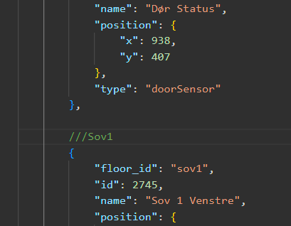

    One more thing :D
    This in the config gives this error :D
    Just to make it easy for me to seperate floors devices I was thinking :D
    Yes, json don't allow comments in the file. I may do a special hack to allow it in the future.
    Ok, there was a bug in the production apps with the config files.
    I have pushed 0.1.4 and it should be available in 15min (it's building on github).
    Do an upgrade and the "Create Configuration" should work.
    Edit: Ok, it's built now and will hopefully fit Create Configuration both for MacOS and Windows. There should be no need to download any of the files from the repo. Just download the app for your platform.

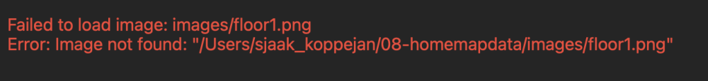

    Jan, after download and install the .14 version.
    This is the first screen after creation configuration still same error.
    The /homemapdata is located in /users/myname
    I created the .env file stored in /users/myname

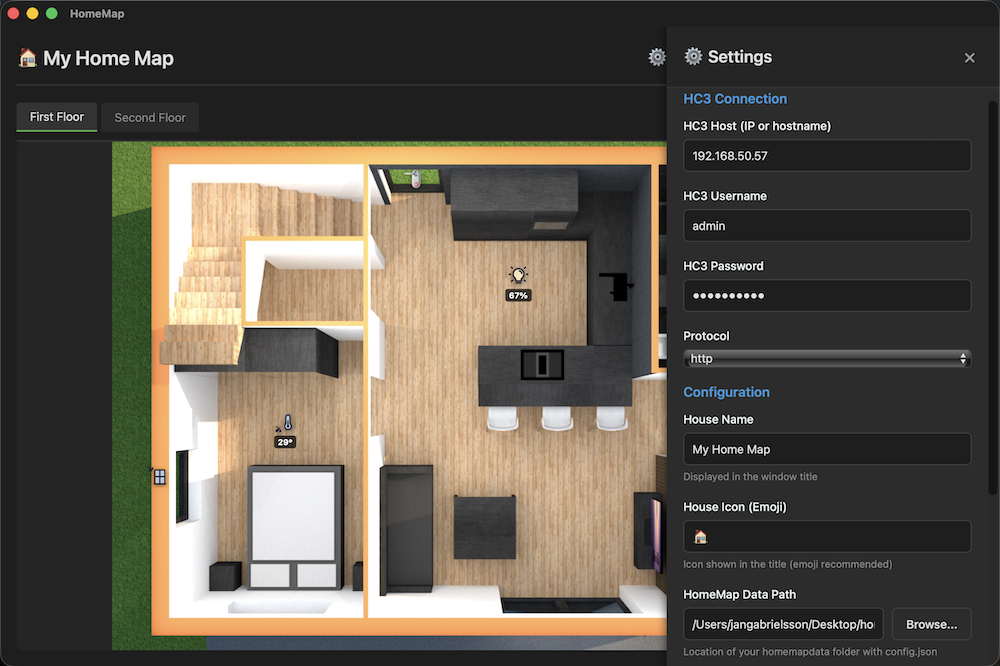

    Yes, the setup instructions says that you need to set HC3_HOMEMAP to point where you put the homemapdata folder

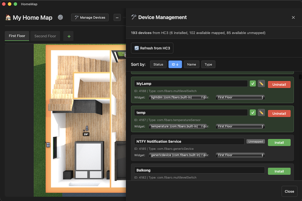

    • Device Management UI: Complete visual device management (no more manual JSON editing!)
      • Add Device dialog (right-click empty floor space in edit mode)
      • Edit Device dialog (change name, type, floor assignments)
      • Delete Device dialog with confirmation
      • Multi-floor device support with visual floor selection
