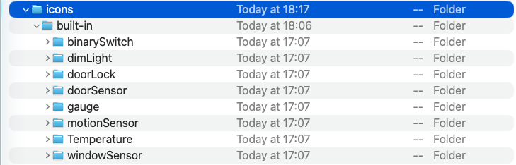

    How's the structure of your homemapdata folder? especially the widgets/*
    Actually, you probably have a folder named widgets/ with all the widgets.json files in?
    If you create a subfolder widgets/built-in/
    and move the widgets.json files there.
    This is the new structure and I thought that I had a backward compatible fix, but not in 0.1.10.
    so move the widgets json files under widgets/built-in/*
    /monthly_2025_10/image.png.5d3a7130a87329744f8de595e478924d.png" />
    Also the icons
    I dit it and now get the full list, thanks

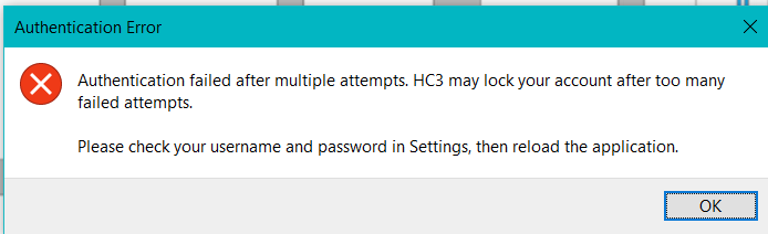

    /monthly_2025_10/image.png.58e05e65601c3bdd8ee555fb185bbdaf.png" />
    BUT I STILL HAVE  the connection error just after pressing the Add Device button:
    Before, closing the application and launching it again regain connection: no more now because the config.json file has been updated with "devices" array as below:

    Just to clarify, if you have a devices in h devices list you can connect? or you can't?
    So there was a lock implemented that would refrain it from connecting again unless one re-saved the settings (the cog-wheel). Thinking that people should correct the credentials. If not the app would try to get events when starting up and immediately complain that there were multiple failed attempts.
    Now 0.1.12 (ready in 10min)  will not try to get events if lock is in place. You need to open settings (cogwheel) and the lock will be reset. Also a place to update the credentials if they were wrong and try "Test connection"

    Ok I have the floor map. If I create under images/built-in and move floor map I get error can't find then file.
    Second once I saw a lamp but now I can't get a light in my floor plan what am I doing wrong?

    Home map is connected at launch but disconnected with the message 1 second later.
    Update done, using the menu configuration I re-enter all credential an save, relaunch application which is again connected to HC3
    Try to add a device in Cellar and 1s after pressing the Add Device button, Application disconnected due to to much failed connections.
    If your floor image path is   "image": "images/Appartement_rev_03.jpg", it needs to be there. If you move it to images/built-in/ directory you must change path to
     "image": "images/built-in/Appartement_rev_03.jpg"
    However, the built-in subduers are only neccessary for icons and widgets.
    See post
    Do you have the widgets and icons in the right subdir?
