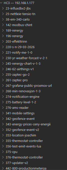

I am trying to use this extension on Windows 11 :D

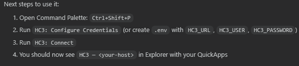

Was struggeling to do the hc3: connect and how it works 😅
Asked AI to look into the extension and explain me in details how it works xD
I mistok "command Palette" and "Command Prompt" the same thing 😅 So the ctrl+shift+P made me find what I did wrong 🤣
Btw it also load the QA with no files (encrypted QAS)
No files show :D Just the folder :)

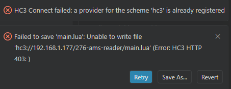

Seems to have to use the admin user? Advanced user with access to all could download, but not upload 🤔 :D
Also after changing to admin user 😄
Is it a disconnect command? 🤔
    Yes, now there is a HC3: Disconnect (v0.2.0 should show up as a vscode extension update in a few minutes)
    You may need to Disconnect/Connect if you change user.
    Interesting that Advanced User with access to all can't upload.
    Can you log in to the WebUI and edit files as the same advanced user?
    Actually I cant edit with the advances user :D
    It says on the button below xD
    @m.roszak Is this something you guys can allow? so we can use advanced users for this type of things?
    Well, the error may be on my side, let me look into it a bit more.

    And still get:
    On the main admin user now
    Edited by Brors94
    Well, the scanning is an internal vscode thingy and actually looks a bit buggy. As you don't have 100000 files it must include local rescans from vscode, and why should the end user care?
    It is noted in the README.md
    So, it doesn't mean that it does a 100000 fetches from the HC3 ;-)
    Vscode's preload can be turned off in settings.json but then you loose the search capability.
    There is a v0.4.2 pushed now - will take 5min to show up in vscode.
    I think I fixed the write problem (at least for admin).

    Still get the same error when saving:
    /monthly_2026_03/image.png.b040ab326dd7ff904a4f80e662cc440c.png" />
    Still on the admin user :) With set credentials with the:
    >HC3:configure credentials
    on v0.4.3 of the extension
    Statstic:
    Total API calls: 98  (since connect, 24s ago)
    Calls by endpoint:
         85  GET /api/quickApp/{id}/files
          7  GET /api/debugMessages
          6  GET /api/devices
    So I aint got that many 😅

    Try v0.4.4 that should show up in a few minutes. Better error message. Strange that I don't have the write problems, and haven't had since the first version. I do run as admin though...
    I am sorry 🤣
    I just realised I set the .env file in the "User" folder to the other account to and when i delted the .env in workspace and used the >hc3: config credentials I tought it would use them as a priority.
    And forgot the .env might be used...
    Since the non admin used gets the output log etc and download I tought I was on the admin 😅
    Works Now!
    Sorry for wastning your time :D
