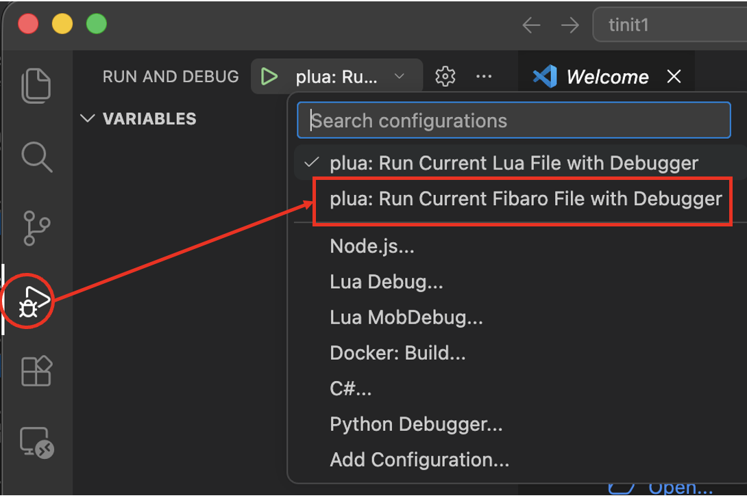

The command >plua --init will create a project setup in a new workspace for vscode. Besides choosing a QA template it will also install /.vscode/launch.json /.vscode/tasks.json The launch.json contains 2 different launch configs: -plua: Run Current Lua File with Debugger -plua: Run Current Fibaro File with Debugger The first config just runs a lua file without loading the fibaro APIs. The second expects the file to be a QA and will load the fibaro APIs and try to start QuickApp:onInit if it exists. Note that when pressing F5 or choosing "Start Debugging" in vscode, it will run the current chosen launch configuration. If that happens to be the first config, in this case, it will complain that there is no fibaro.* or api.* functions available. In vscode we select the launch config in the run and debug side panel.

Hi @jgab, referring to my assistance requested, because of the problem attempt to index a nil value (global 'api')The problem was solved... ; just for your info.... i found the launch json as follows... { "version": "0.2.0", "configurations": [ { "name": "PLua: Current File", "type": "luaMobDebug", "request": "launch", "workingDirectory": "${workspaceFolder}", "sourceBasePath": "${workspaceFolder}", "listenPort": 8172, "stopOnEntry": false, "sourceEncoding": "UTF-8", "interpreter": "plua", "arguments": [ "${relativeFile}" ], "listenPublicly": true }, { "name": "PLua: Current File with Fibaro SDK", "type": "luaMobDebug", "request": "launch", "workingDirectory": "${workspaceFolder}", "sourceBasePath": "${workspaceFolder}", "listenPort": 8172, "stopOnEntry": false, "sourceEncoding": "UTF-8", "interpreter": "plua", "arguments": [ "--fibaro", "--run-for", "60", "${relativeFile}" ], "listenPublicly": true } ] } I donever open config files... ad I do not know when/why such modify occurred, however deleting that area, the system resumed normal working conditions... many thanks Ciao Giovanni

Yes, please continue the discussion in the plua forum thread. You are probably using the wrong vscode launch task. You need to use the "Plua: Current Fibaro File" when running/debuging. That will add the --fibaro flag that loads the fibaro libraries like api.* { "name": "Plua: Current Fibaro File", "type": "luaMobDebug", "request": "launch", "workingDirectory": "${workspaceFolder}", "sourceBasePath": "${workspaceFolder}", "listenPort": 8172, "stopOnEntry": false, "sourceEncoding": "UTF-8", "interpreter": "./run.sh", "arguments": [ "--fibaro", "--run-for", "0", "${relativeFile}" ], "listenPublicly": true } - Last week
