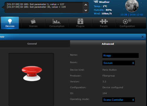

I just updated to 4.120, and my red Button still doesn't work. I can add and remove, but pressing the button does absolutely nothing.

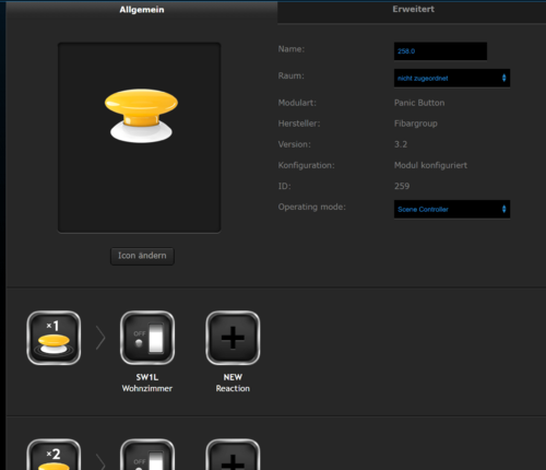

@mobbie
What is your wake-up setting = "0" or another value from your button ?
My button says "transfer ok" in the GUI but it doesn't execute the function, which is to turn on the lights in a room. It has perhaps worked once.
