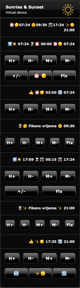

  • Sunrise & Sunset VD v1.4.0 - Modified main loop code to better handle global variables. Variables are now automatically repaired and are not reset to default settings after HC2 reboot. Added variable SunriseIcon to store VD icon ID and now when main icon for VD is set also all button icons are set automatically.
  • Home Status VD v1.1 - Added variable HomeStatIcon to store VD icon ID and now when main icon for VD is set also all button icons are set automatically. Added label that shows most important values on VD when closed.
  • Home Timers VD v1.1 - Added variable HomeTimersIcon to store VD icon ID and now when main icon for VD is set also all button icons are set automatically. Added label that shows most important values on VD when closed.

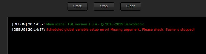

    Hi @Sankotronic
    I can not solve the problem. Now I have another message :(
    How do I change global variables? I tried in several ways. I'm trying to figure out how to do it because I do not know programming. If I leave global variables the way you wrote them, is not it ok?
    Looks like I'm not doing well what I do.
    It needs to be changed elsewhere except GLOBAL VARIABLES
    Thanks for the help.
    I appreciate everything you do!
    You must manually add predefined variables.
    Go to Panels - >Variables Panel -> Press button - Enter
    Scroll down and Add pedefined variables.

    Guest dacianova
    Thank you
    Thank you
    Thank you
    Now I understand what I have to do.
    I didn't know that I had to go to the Panels to set Global Variables
    Thank you.
    You are a life saver!
    Some variables are added after installing VD and running Debug. If they are missing, they should be added manually. Read the instructions from Master Sanktronik. It is in pdf. Good luck. ;)
