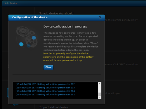

    I gave this another go this evening and I managed to get another 2 included but I cant seem to see any pattern
    The ones now that have included successfully are all at 1.7 and what I have left are all newer
    I assume that 1.07 and 1.7 are the same thing ...
    it support OTA FW updates it is saying that it is up to date...
    Only one included fully - the other successfully included the temp sensor and I have to do reconfigure and it worked then
    The biggest problem is that they are including as a ID 0  (see screenshot) _ i currently have 4 doing this.
    I checked the box and there is nothing of use on the label
    my gut tells me there is nothing wrong with the sensors and its either 4.11 or the power supply
    all ideas fully embraced
