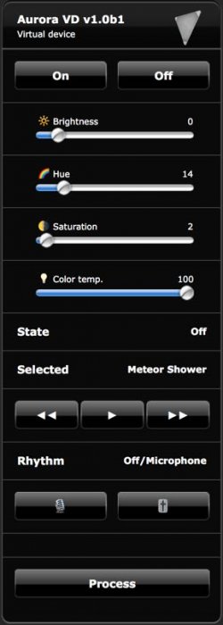

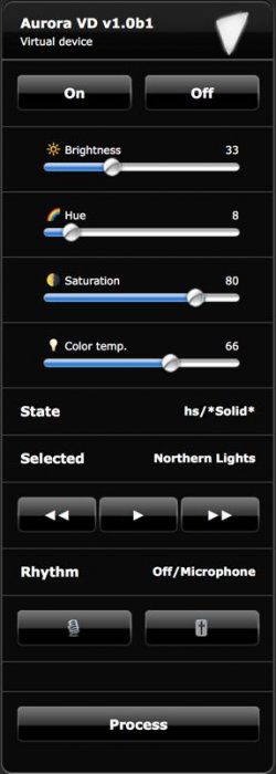

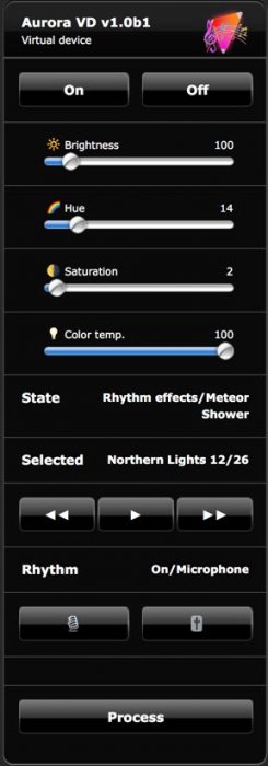

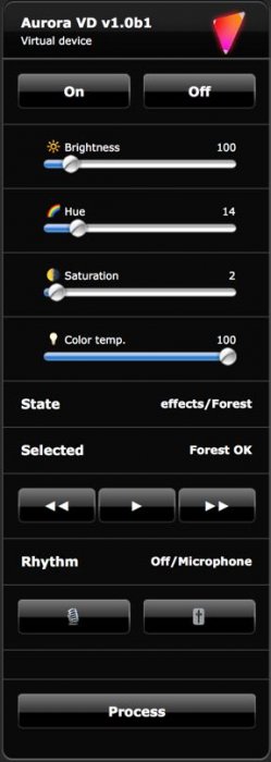

    Just a very simple Nanoleaf VD, that cycles trough the stored effects. It can adjust the brightness for some effects, depending on effect definition.
    This device is using a global variable "NanoApi"  containing "/api/v1/kzcaSSBAaDwVZMkxsUKF3VlOJcd5yPri", where  "kzcaSSBAaDwVZMkxsUKF3VlOJcd5yPri" is your API Token.
    Use it, change it, delete it.... whatever you want :-)

     Hi @Bodyart
    I like it :) I did integrate the Hue / Saturation / Color Temp. Slider and now I replace my old VD.
    In my case, I did keep the authorization token in the VD because I think with more than one Aurora the global variable setup won't be easier.
    Hue Slider
    Saturation Slider
    Color Temp. Slider
