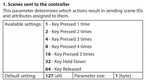

    The number of clicks responsible for triggering:

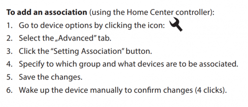

    So I reconfigured the Button again and it sort of works, but not every time. If I use the actions feature in the button and choose for it to switch on "lights" it does not work. If I create a scene it sort of works, but not every time though. The way I have it set up is that the button runs a scene for switching the lights ON and one for switching them OFF. It is very sluggish and is not very practical as a light switch as you just want to press it on your way through the doorway and not stand and wait to see if it works and maybe having to press it more times. Would it be a better solution to use associations? And would it then communicate directly with the bulbs instead of going via the HC2?

    So my Fibaro Button has gradually gotten worse and last week it stopped working all together. I wasn't even able to reset it and re-ad it. The webshop I bought it at sent me a new one, but it isn't really any better than the old one was a few weeks ago. I just can't understand why it is so unreliable? The Button works most times when I have it in the same room as the HC2, but when I have moved it to the room where it is supposed to work as a light switch it stops working almost all together. It is in a room with 6 devices that all work as repeaters so why it doesn't work is beyond me. But could using associations to directly control the bulbs be a solution and does The Button support that? This is my last effort at using this button, before I buy another switch.
