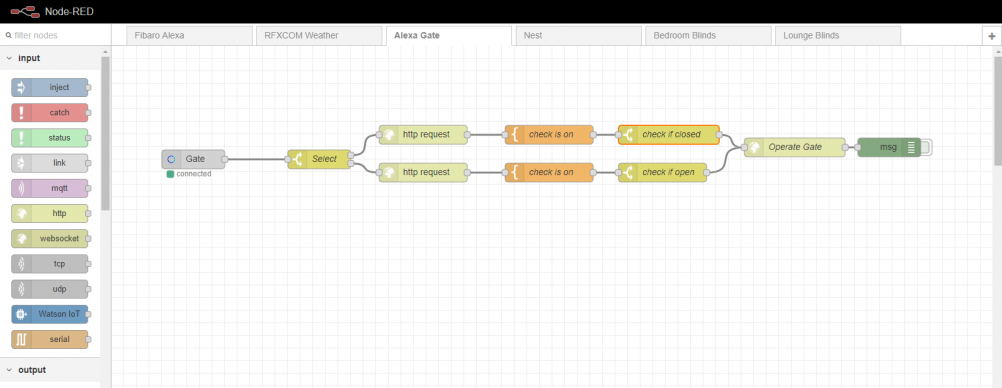

Hi @Sankotronic
Like a few others i have been using node red to do all the clever stuff, if you have a play with node red i think you will find that all the hard work you have done would be easy to transfer to any controller, thus avoiding the Fibaro dead end road
i now use node red for alot of alexa, finally i have managed to control my screenline blinds (node red via rfxcom)
you just push and pull info out of the HC2 and connect to my nest
and i can use Alexa to turn on lua scenes
Its like being let out of a cage !!!!!!
