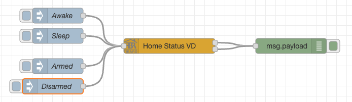

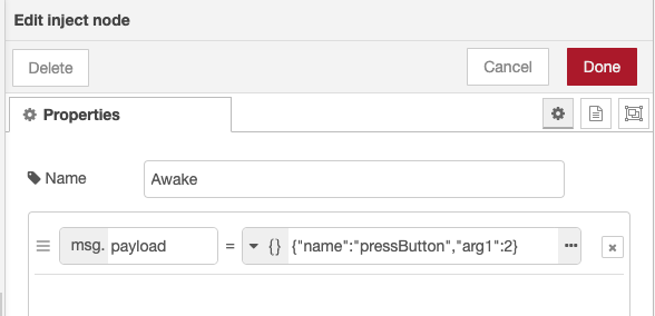

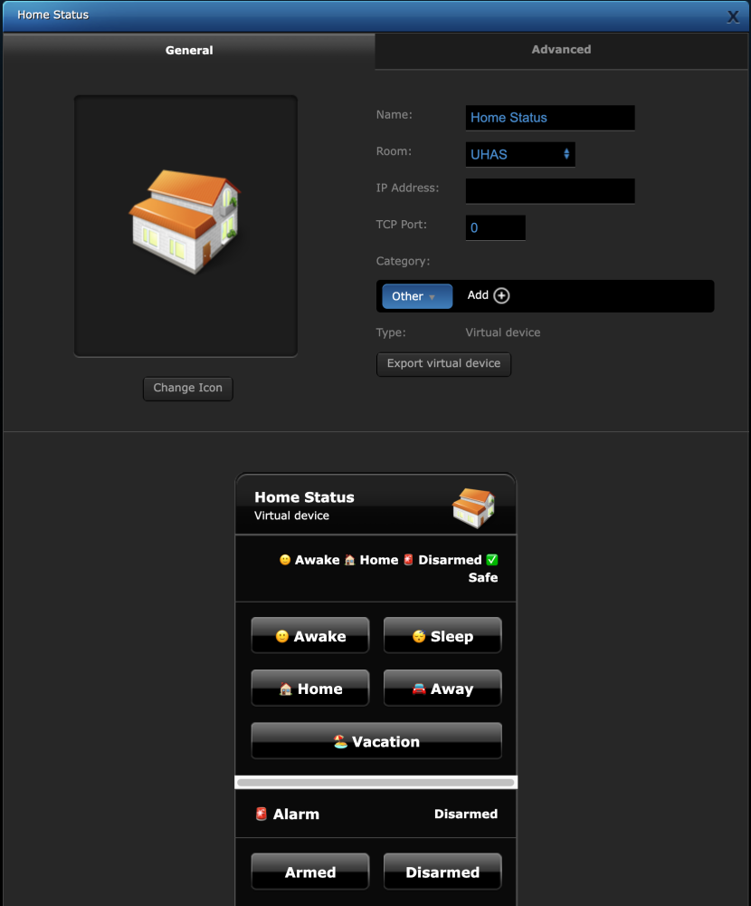

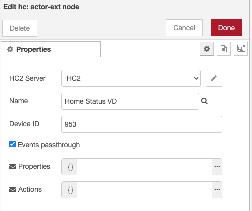

    Hi @10der
    can you help me please .  I don't understand the logic of this . What should i wrote in the inject node and Xactor node when i want change the value of Label2 on the VD device nr 135 ?
    thank you
