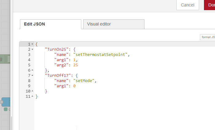

    @drboss your json not correct 5 min!

    I send as string but, I don't why its not work after upgrade to 0.18. Before work fine.

    When I open forum topic to write that I find error:
        "Test1": {
            "name": "setThermostatSetpoint",
            "arg1": 1,
            "arg2": 25
        "Test2": {
            "arg1": 1,
            "arg2": 17
    I read that You find my problem too. Thanks ;-)
    I confirm for thermostat it's work, but in the older version (before 0.18) I sure that list of args [ ] work fine because I use it :-) in "production"
