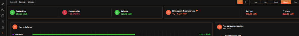

This Quickapp retrieves energy consumption, energy production, gas and water usage from the (P1 Monitor) energy, gas and water meter.
This Quickapp uses the software of ztatz.nl to get the values from your smart energymeter.
The ztatz plug-and-play software can run on a Raspberry Pi or in a Docker container.
The Energy consumption and energy production are added to the HC3 energy panel.
Use the child devices Todays Consumption and Todays Production to store energy data (kWh) in the Energy Panel.
And use the child devices Consumption and Production for instantaneous power (Watt) in the Energy Panel calculations.
