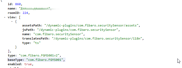

    I have
    /monthly_2020_11/image.png.cb201103bd1913b61db1928edda7b80f.png" />
    call
    fibaro.getDevicesID({isTypeOf = "com.fibaro.motionSensor"})
    as you can see Type is motion but my foibaro sensor is
    • type: "com.fibaro.FGMS001v2",
    • baseType: "com.fibaro.FGMS001",
    so trying
    yay!

    I have
    call
    so trying
    yay!

    I have
    call
    so trying
    yay!

    -- 860
    local doorWindowSIds = fibaro.getDevicesID({isTypeOf = "com.fibaro.doorWindowSensor"})
    local motionIds = fibaro.getDevicesID({isTypeOf = "com.fibaro.motionSensor"})
    local tree = api.get("/devices/hierarchy")
    local result = findType(tree, 'com.fibaro.motionSensor')
    collect(result)
    --print(json.encode(result))
    local result = findType(tree, 'com.fibaro.doorWindowSensor')
    collect(result)
    -- print(json.encode(result))
