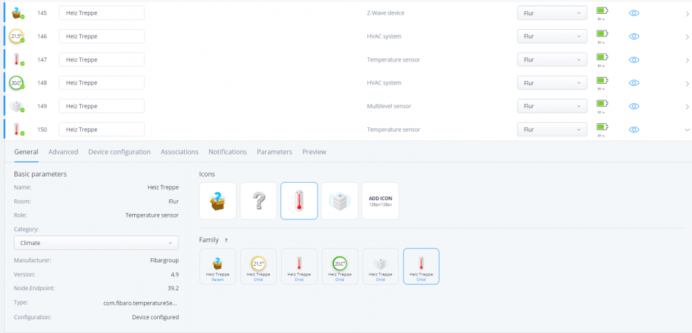

Both of those successfully updated lost connection to the BT temperature sensor.
My steps neccessary after update:
  1. Soft reconfig
  2. Setting parameters (lost after reconfig)
  3. Re-adding to the climate zone
  4. Re-pairing with the BT temperature sensor
Thanks guys for providing as much info as possible. @danidani Thanks, I've edited my post above to incorporate your remarks about "post upgrade".

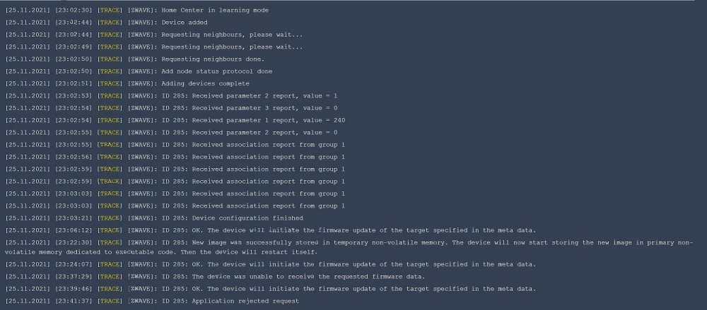

Here my HC3 logs if could help
Device start update at 23:06
Edited by Fyase
