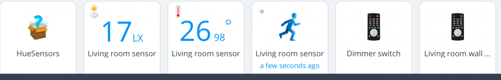

This example uses 3 Hue devices, a motion/lux/temp sensor, a light (Tim), and a switch.

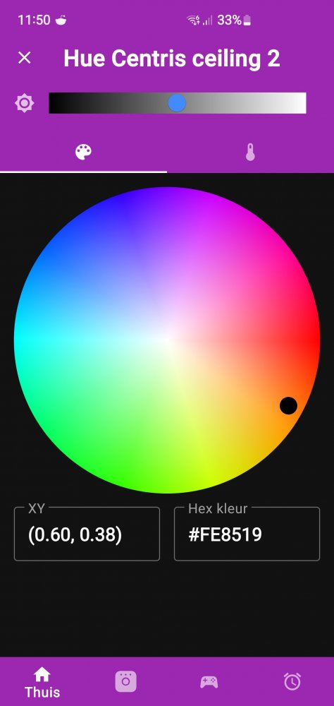

    You need to find some xy value that work as "a tad blue", or some colorstring that is close enough.
    If you find your values I can add "a_tad_blue" etc to the color table :-)
    In hue essentials you can get the xy and hex for the colors.
    Also this might help, all x y for populair scene's

    Jan will there be also integration in ER or can we use in several QA's :
    is 0)  transition time?
    or can we change white by x,y
    If not can you please add the main HUE colors?
    Edited by Sjakie
    request for color names

    I pushed a new version of HueConnector v0.12. It's mainly bug fixes.
    There is also a new QA, HueSensors, that uses the HueConnector and creates child devices for all the Hue sensors and buttons. These can then easily be used from HC3 scenes etc.
    (No support for lights!)
    It can in principle handle everything with buttons, light sensors, temperature sensors and motion sensors.
    I will add support for the Hue wall plug (even if it's technically not a sensor) and the Hue Tap with the rotary dial in the coming days.
    'HueSensors' is also available via QAUpdater.
    It's interesting how "simple" and straightforward it becomes to creates devices using the HueConnector. Here is the code for HueSensors (it also uses my QuickerChild and HueClient library)
    • Like 3
    Jan... Thank you for keeping developing this :-) - its really easy to use, amazing work.
    As soon EV4 can address the lights via the HueConnector - i will migrate everything to this .
    Enjoy the weekend everyone ?
    Thanks, HueSensors is kind of the guinea pig for HueConnector. I have discovered some bugs and I'm still wrestling with HueSensors and HueConnector getting out of sync sometimes- but I'm on to it ;-)
